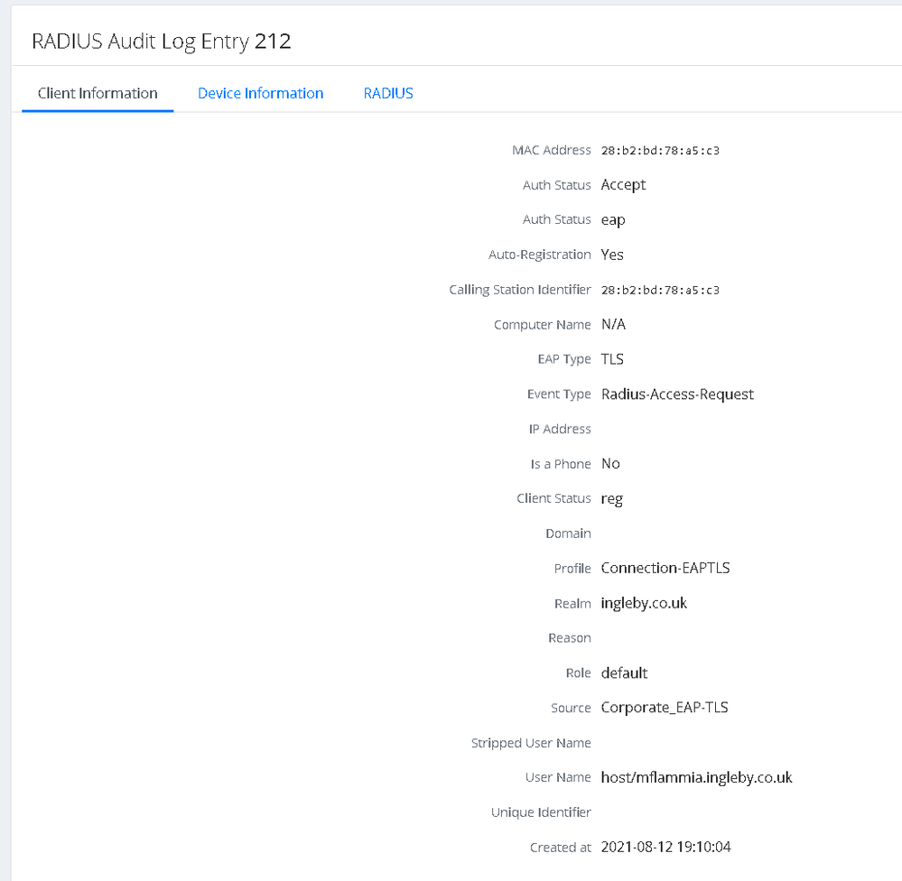

So here is my scenario; just doing certificate authentication, my certificate CN is as follows:
mflammia.ingleby.co.uk
When the devices connects using EAP-TLS I see the following:
This is perfect and works as expected.

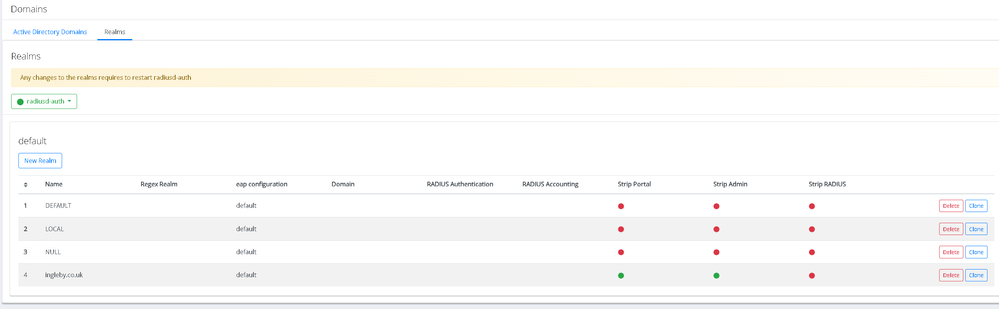

What's happening here is I have the ‘Strip Radius’ disabled:
So when the username gets extrapolated from CN, and with Strip Radius disabled, it shows up in the A3 with the username of:
host/mflammia.ingleby.co.uk
Now the domain of ‘ingleby.co.uk’ can match to a realm called ‘ingleby.co.uk.
