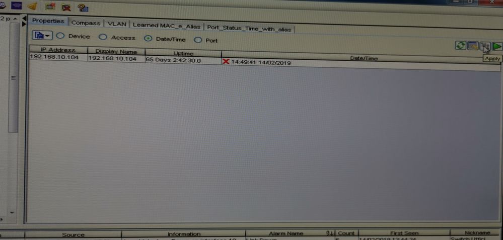

If you check the console log should see the error "Device does not support setting Date and Time.".
So you'd need to change it via CLI.

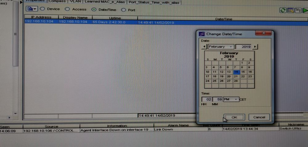

Yesterday the helpdesk technician tried to set (via telnet) the reference NTP server and the time zone and apparently he succeeded on the b5 series but not on XOS and in fact on these (x440, x450 and x460) the hour it's one hour ahead.
Today I would simply like to change the time via netsight but I can not do it and the time remains always set.
It should be easy to change the time with netsight, I do not claim the time zone but the time should be changed easily.
So my questions are 2
1 Why is the time ahead of an hour on the XOS devices?
2 How can I change the time through netsight? (on the xos I saw that it is not possible)
If I click OK...
