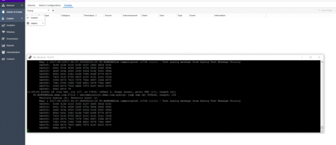

Hi, I've got in my demokit environment a strange problem.
My EMC for some time has worked well as syslog server, but not despite the fact that I see the syslog messages correctly received in the /var/log/syslog file
46241964734d42b9b20740b9ee49a044_RackMultipart20170823-128207-85qw8c-Capture2_inline.gif
in the Oneview page or in console, these messages are not shown.
If I made a tcpdump on EMC interface where receive the syslog messages, I see these message:
46241964734d42b9b20740b9ee49a044_RackMultipart20170823-88554-sd5fmk-Capture2_inline.gif
and with netstat -na I see the port 514 correctly open and the syslog process is running.
I've also tried to made a backup of the EMC server and to install a new one and restore the previous configurations, but the problem still remain.
How I can debug this problem more in deep for resolve it?
Thanks

Antonio_Opromol
Contributor
Hi Bharathiraja,
I've found the problem was infact due to an error setting in the syslog alarm manager where the path were set to /var/log/messages instead to /var/log/syslog
6b9388d882f8428a9633c304cbcafbce_RackMultipart20170823-95659-m703dl-Capture2_inline.gif
The strange is why tis path is changed for some reason (for several time the syslog has worked without problem).

Antonio_Opromol
Contributor
Yes, of course in the event viewer I've select to see the syslog messages.
7771b1bdceef48d992288f0309f39128_RackMultipart20170823-28225-l2q6ho-Capture2_inline.gif
