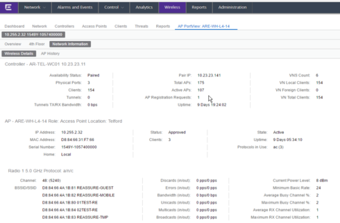

When doing a search for an AP by name, serial, IP or selecting it via the Wireless -> Access Points section, it would be really useful to see what switch, and switch port it is connected to - which is one of the useful features the tool has in tracing where end-systems are connected.
Below is a few examples of the various places AP information is provided, but no detail on where in the network the AP is physically connected:
9b455bcef08d46b4884a28d025abc33a_RackMultipart20170801-101065-tzaj2r-AP-Connect_inline.png
9b455bcef08d46b4884a28d025abc33a_RackMultipart20170801-81182-rmpx7q-AP-Connect-2_inline.png

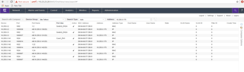

One way in I can see where the AP is attached is to do a compass search, as per below:
9b455bcef08d46b4884a28d025abc33a_RackMultipart20170801-16270-1h1q45c-AP-Connect-1_inline.png
Just wondered if there is any other way, or the possibility could be added or is coming to show the information in the Oneview.
