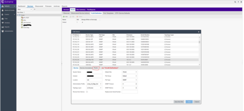

Sometimes Netsight 8.0.x does not allow VLAN Definition on new switches.
See here - EXOS Switch with V16.2.4.5:

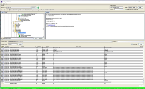

If i start MIB Browser i can read VLAN Information.
At next day it works ...
It seems that there needs to be a overnight run to recognize the ability for 802.1Q MIB VLAN Management ...
Does anybody know how to trigger this process (that i do not have to wait overnight) ?
Or is there another reason why netsight does not offer VLAN Definition on this switch ?

i recognize that Q-Bridge MIB will only (fully) supported started with EXO 22.1.x.
So EXOS 16.x will not work!
Q-Bridge MIB seems to be provides only on part - but NOT in that part that Netsight can manipulate VLANs.
