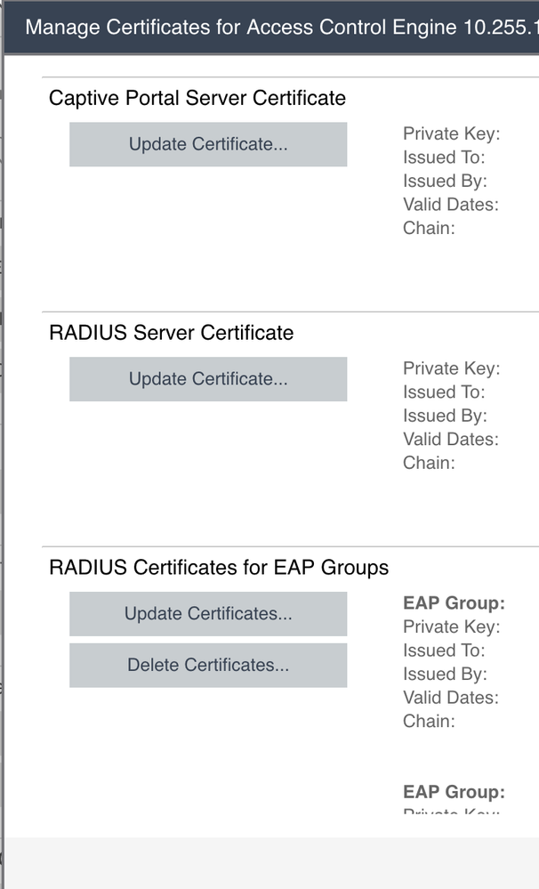

As of 8.5.3 ExtremeControl has the ability to use multiple RADIUS certificates using EAP Group Mappings.
The determination of those certificates is done using EAP Group Mappings via the exchange of RADIUS packets to look at User-Name, NAS-IP-Address (Switch IP) or Calling-station-id (MAC Address), as per below:
You can then use a POSIX regular expression to find a match:

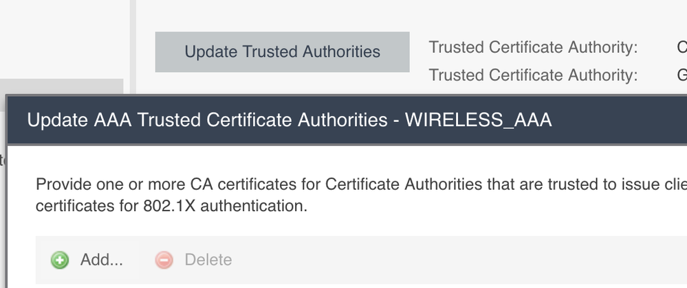

If each client has installed only the root and intermediates that belong to its own PKI, it becomes critical that the right NAC / RADIUS certificate is returned / presented to the client - hence back to what criteria to use?
In regards to AAA configuration, which is used to validate the client certificate / authentication, do you know if I can install root and intermediate certs for each of the PKI's in the same place?
That way the client certificate presented to NAC will be able to chain automatically against the right ones?

There should be some misunderstanding on the feature.
The EAP Group Mapping will define which certificate will be presented by the RADIUS server based on the Username/NAS-IP/MAC.
The authentication as such will be performed with the info available in the AAA config. No need to play here with the EAP Groups:
You need the EAP Groups if the client is validating the RADIUS certificate.
The purpose is to present a specific RADIUS certificate.
I use the following use case:
I the check the Usernames like "host/computername.private-domain.local" for computer authentication and the via the EAP Group I check the username and I present a RADIUS certificate that was issued by a Root-CA available on the specific computer.
You can request the users to log-in with something like [email protected] to ensure that you'll present an acceptable RADIUS certificate for the client.
If non of the EAP Group is matching, the default RADIUS certificate is presented
The default RADIUS is presenting a certificate from a public authority. It is usually a star certificate (for example *.public-domain.com).
I must use this because the BYOD devices do not have any Root CA from private PKI by default.
I upload this certificate in the "RADIUS Server Certificate"
