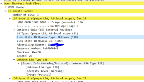

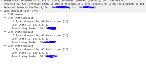

I did some wireshark traces and found that when the XSR requests the LSA DB for the DC switches, the LSA-Type 11 updates is then sent to the XSR.
OSPF Request:

The XSR then complains that this is an unknown LSA Type and then requests the DB again for the DC switches.
