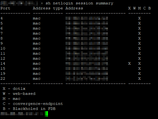

we have downloaded the mib file for our exos version. I can't find the right OID to readout if a device on a port is authenticated by dot1x or mac.
On the Switch i can see those information with this command. Does anyone know if there is an OID which readout that information?
We also need an OID to toggle mac based authentication. On the exos switch the commands would be:
disable netlogin port X mac
enable netlogin port X mac
Best regards
Stefan
