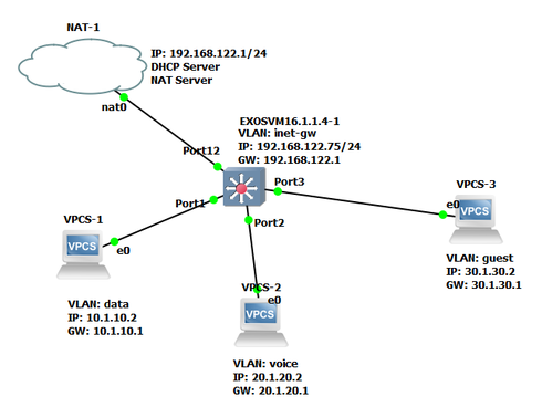

Newbie to networking and Extreme Networks switch and trying to set up a simple config at home. I picked up a Summit 450e defaulted to factory config with a 15.6b image. I have created 4 VLANs - data,voice, guest and inet-gw. Port 1 is data, Port 2 is voice, Port 3 is guest, Port 12 is inet-gw. PC attached to each of ports 1, 2 and 3 and a verizon router attached to port 12. For purposes of simulating using GNS-3 I used the NAT-1 appliance instead of the actual Verizon router. I am able to ping each PC from each of the other PCs connected to the switch. I am able to ping www.google.com and other publicly accessible internet sites from the inet-gw VLAN on the switch using the console (hence showing that the NAT-1 connection to the switch works). The problem is that i cannot reach the internet from any of the PCs connected to the switch (i.e. from the data, voice, or guest VLANs). I followed Drew C's post that showed a very similar set-up but he did not have any actual configuration commands so obviously I am missing something in my config. Have been messing with it for the last two days but no luck so throwing myself at your mercy now...config schematic below...
* Summit-PC.11 # show vlan ----------------------------------------------------------------------------------------------- Name VID Protocol Addr Flags Proto Ports Virtual Active router /Total ----------------------------------------------------------------------------------------------- data 10 10.1.10.1 /24 -f--------------------------- ANY 1 /1 VR-Default Default 1 ------------------------------------------------- ANY 0 /0 VR-Default guest 30 30.1.30.1 /24 -f--------------------------- ANY 1 /1 VR-Default inet-gw 100 192.168.122.175/24 -f--------------------------- ANY 1 /1 VR-Default Mgmt 4095 ------------------------------------------------- ANY 1 /1 VR-Mgmt voice 20 20.1.20.1 /24 -f--------------------------- ANY 1 /1 VR-Default -----------------------------------------------------------------------------------------------Ori Destination Gateway Mtr Flags VLAN Duration

You could try one of the free software routers available for GNS3 instead of the NAT-1 device. For example one of the LEDE, OpenWRT, BSDRP or BIRD router appliances. There you can configure static routes towards the client networks.

Thanks for the reply. IP forwarding is enabled on the Vlans. I can ping 192.168.122.175 on port 12 from the other PCs but not 192.168.122.1 - it cannot see that for some reason. The NAT1 device in GNS-3 does not allow for any configuration. Attached below is the config and the message I get back when I ping from VPCS1 (PC 1)...

The reason why the ping is successful when pinging from switch may be the source address of that ping request is switch's local 192.168.122.175 which NAT-1 device also knows this network (192.168.122.0/24) as its direct interface.
I think the ping won't be successful when you ping from switch with different source address for example, "ping 8.8.8.8 from 10.1.10.1".
As long as you want to have separated network for each data, voice and guest, appropriate routing is required.
