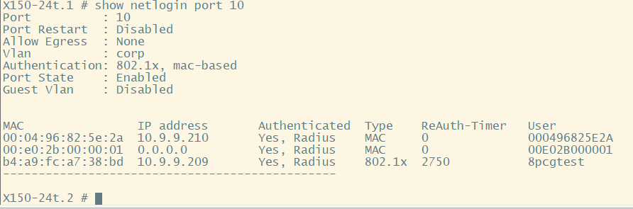

The x460 switch sets configre netlogin dot1x timer re-authentication 0, can't effective, as if no matter what value is set,
the authentication countdown is always over 6000 seconds, when the countdown ends, the network will automatically interrupt,
please ask how does the switch need to set up

Hello,
I would look at the command 'configure netlogin dot1x timers reauth-period ...' to set this value locally.
Note that any session-timeout value sent via RADIUS will have priority over this setting.
