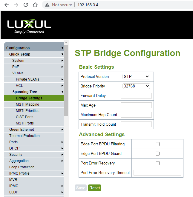

I was able to get my hands on one fresh out of the box and log into it. Looks like STP is built in and on by default. Unfortunately, I didn't find an option to turn it off. I did happen to change it to STP (MSTP by default) and it was able to connect to the X465 stack and receive a DHCP address without freezing the switch. BPDU guard/filtering and other advanced settings were not enabled fresh out of the box. Picture below:

Hello,
It seems like the AMS switch is disabling the port towards the x465 when connected. The 'link down - Local fault' on the x465 indicates that the other device (the AMS) brought the link down. This may be because EXOS has STP running in the default VLAN by default (on all ports by default). If the AMS has something like BPDU-Guard, it may be disabling the port due to STP.
I'd check the AMS switch logs to confirm, or you could try this connection with STP disabled on the x465 (disable stpd s0), but be careful of network loops!
