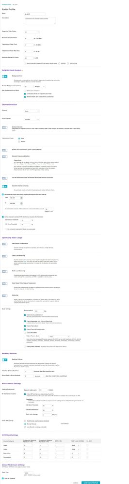

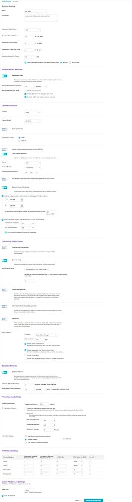

these are the config:
additional settings - optional settings

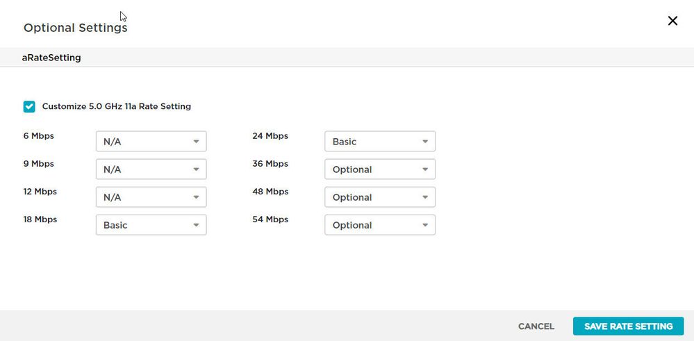

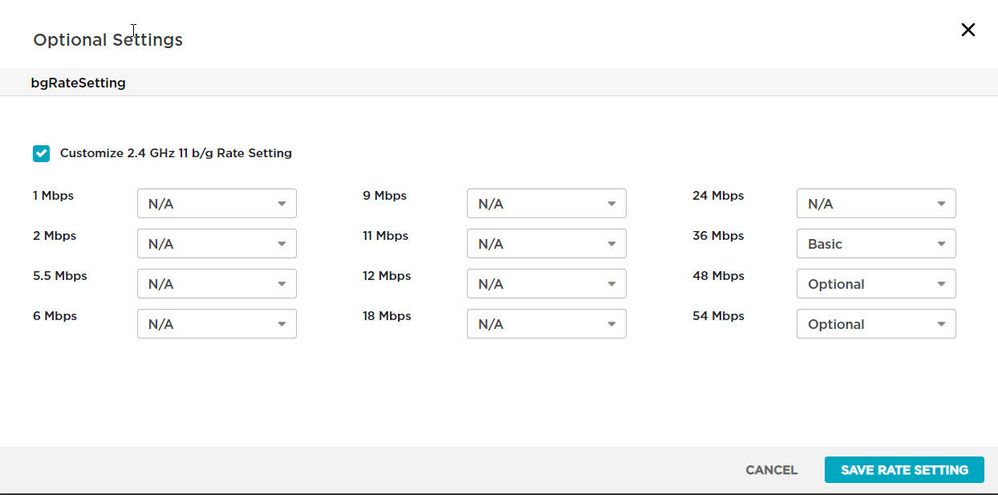

1. turnoff 2.4Ghz 1-24, set 36 to be basic
2. turnoff 5Ghz    1-18, set 18 to be basic
radio profile
3. ng0_clone 2.4Ghz
 deny-client: 80211b
 maximum transmit power: 10
 band-streeing: encourage 5 ghz band usage
 number of connection attempts from 2.4Ghz client to ignore before responding: 3
 weak signal probe request suppression: off
 safety net: off
 enable frame burst: off
 enable short guard interval: on
 enable aggregate mac protocol data units: on
 enable VHT for 2.4Ghz: off
2. ac0_clone 5Ghz
 maximum transmit power: 14
 high density configuration: off
 client load balancing: off
 radio load balancing: off
 safety net: off
 enable frame burst: on
 enable transmit beamforming: on

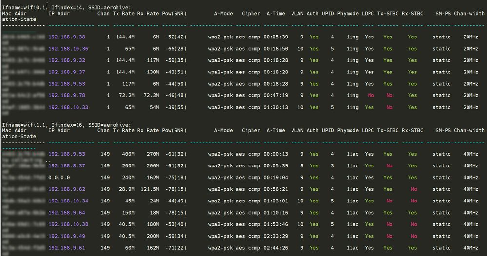

but the nearly half of clients choose to associated 2.4Ghz band, how to solve this problem?

It is ultimately a client side decision on which radio to use. There may be devices specific settings influencing that behavior. You’ve set the radio profile to encourage 5GHz use, if the device is able to use 5GHz it will comply, otherwise it will use 2.4GHz instead after rejecting the 5GHz suggestion 3 times.
As a side note, I wouldn’t personally get that aggressive with turning off the data rates. You might have clients with a weaker connection that could typically still connect but are now blocked because they don’t meet the basic data rate you’ve set. Just something to think about.
