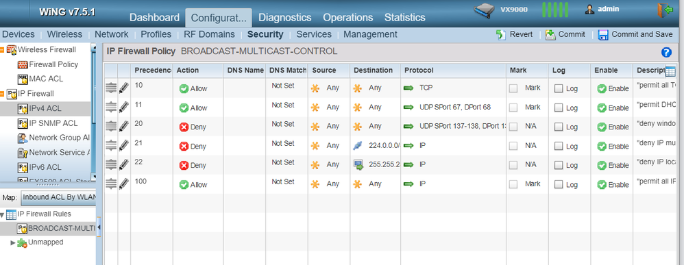

Hi, Please check also ipv4 acl rules,
regards,
Tomek

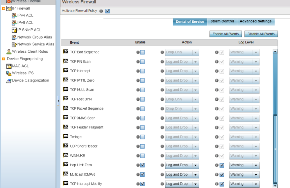

Thank you Tomek. Disabling the IPv6 firewall (under advanced settings) has now allowed clients to get DHCPv6 addreses. DHCPv6 uses IPv6 multicast.
Clearly disabling that IPv6 firewall isn’t ideal but I think we can live with it for the time being.

Do you have any firewall rules regarding multicast ? eg.:
BTW 7.5.1 seems to be buggy.
