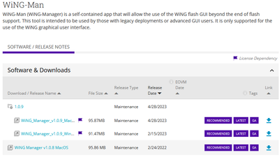

Is this what you are looking at?
I'm assuming you have access to the support portal.
Kogilan
Thank you for your help, my manager was able to download WiNG-Man with his login credentials.
I am sorted now, I can login and setup my AP's.

Ok thanks for the info, I should be able to do the setup if i can get the WiNG Manager tool, problem is there is no link under downloads. How else can i download WiNG Manager tool?
