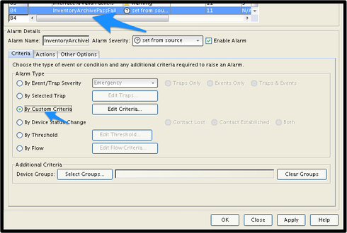

Okay, Here is a template for you which is a good starting point for the concept anyways. I am generating as a goal, just an email based on inventory manager archive message "Archive Save"
Start by loading Alarm Manager from Console - Tools->Alarm/Event->Alarms Manager
Click on New Alarm
Once that is selected, select the Criteria Tab and By Custom Criteria Button.
f440191b6f064bdb86f3546866e8211e_RackMultipart20150730-27913-p75e1-Screen_Shot_2015-07-30_at_8_14_45_AM_inline.png
Click Edit Criteria as noted above
I selected Match on Log Manager for Inventory. I added the Match on information text string "Archive Save" and then selected that. See below.

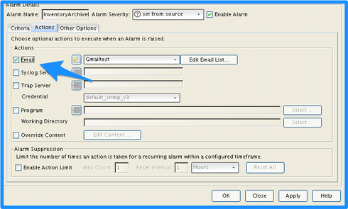

Click OK on the edit custom Alarm Criteria and then click on Actions Tab While still selecting this alarm. Set the Action to Email. (When I had trap server enabled toit was giving me the Clear Alarms bit)
f440191b6f064bdb86f3546866e8211e_RackMultipart20150730-4769-yu5yva-Screen_Shot_2015-07-30_at_8_15_26_AM_inline.png
Now, I went and stamped a new version, and regardless of whether it pass or fails, I get this message, because I was searching on a string for that simple message.
And here is the email message from my improperly assigned controller.
Device: 10.0.0.250
Severity: Error
Message: Archive Save New Archive: (10.0.0.250) Version Stamp: Jul 30, 2015 11:18:47 AM - Configuration Upload script is empty in file Extreme Networks Wireless Controller - SCP
So let us know if this gets you going, or any feedback to make a better solution out of it that meets your goals.
