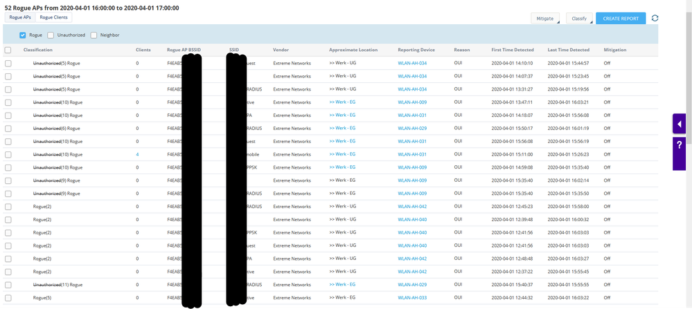

We are running 20.1.3.2-NGVA on Premises and overall we are running about 50 Access points in our network
All AP130 are reporting "rogue" state at the security category, so i am wondering what to do now.
I guess the following picture will help you.
And what could i do with the option "mitigate"?

Could you tell me what firmware your APs are using? If you have any devices (130 or otherwise) that are using a version other than the latest recommended version, could you update to the latest to see if that resolves the false rouge reports?
This chart lists the latest recommended firmware per device model: https://thehivecommunity.aerohive.com/s/question/0D50c00007NeN2jCAF/hiveos-matrix
Also this page discusses the mitigation settings available, for more detail on that: http://docs.aerohive.com/330000/docs/help/english/ng/Content/gui/configuration/configuring-wireless-intrusion-prevention-system.htm
