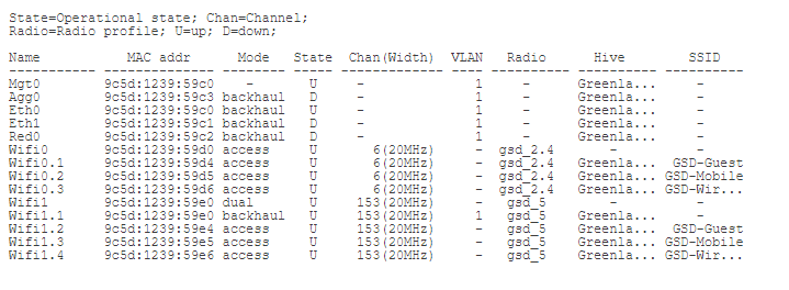

jsettlemoir
It looks like they're all up; I attached a screenshot if I'm reading it wrong. 86ce5a82e2b14d50b59c50c5b5d110b0_0690c000007rWdcAAE.png
AnonymousM
Valued Contributor II
Joshua,
Do you know if the AP is broadcasting SSIDs? You can check the box for the AP, go to Utilities and look for Interface. This will show you all of the wifi0/1 (sub)interfaces for the radios. The 4th column will show you a U/D for up/down. The last column will most likely be truncated, but should show part of the actual SSIDs (if any). Do you see any of this? There's a chance the radios are disabled or possibly even faulty and simply not working (although I believe you'd get an error updating the AP if this was the case).
