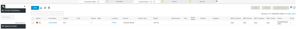

I did a reset of the device added with the serial number.... does not connect. The above screen caps show the settings.

It says
Could not view configuration on device 263333034952394. There is no version for the device, try to setup a CAPWAP connection to HiveManager.
