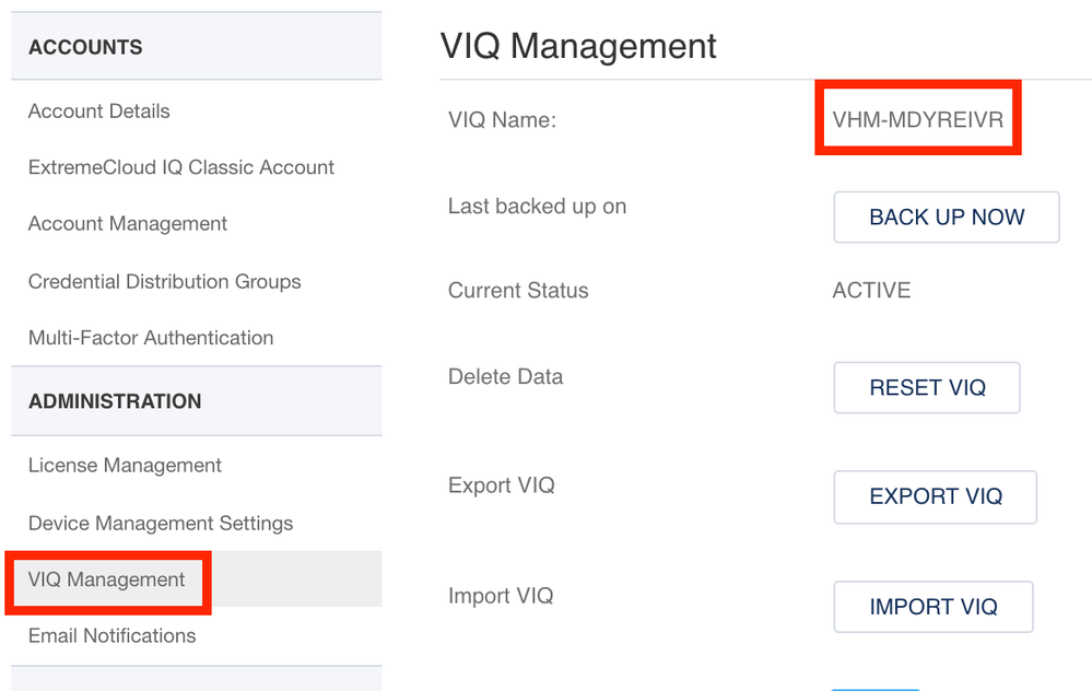

The log does show a disconnect around 13:40, but this log doesn't indicate what caused it outside of the ah_capwap_event_timer timed out. Capwap is latency sensitive and occasionally picked up by firewalls with IDS/IPS rules enabled because of the nature of the protocol. There could also be some capwap settings from the original HM Select account like the VHM-ID that might be causing issues.
Run #show capwap client /*and note the VHM-ID compared to your HM Connect Instance
CAPWAP client: Enabled
CAPWAP transport mode: HTTP on TCP
RUN state: Connected securely to the CAPWAP server
CAPWAP client IP: xxx.xxx.xxx.xxx
CAPWAP server IP: 34.202.197.42
HiveManager Primary Name:cloud-va2-cws-10.aerohive.com
HiveManager Backup Name: hmng-prod-va2-cm-01.aerohive.com
CAPWAP Default Server Name: redirector.aerohive.com
Virtual HiveManager Name: VHM-MDYREIVR
