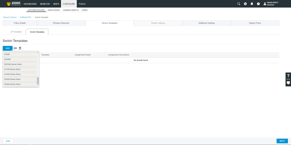

In the 'Policy Details' Section of the Network Policy, do you have the 'Switches' box checked?
If so, then under 'Device Templates' a new sub-menu will appear showing 'Switch Templates'

All this is selected, however you found the switch template in the same location as i did, not as per the documentation
Have you followed the document and created a stack, the Stack numbers do no appear within the template
