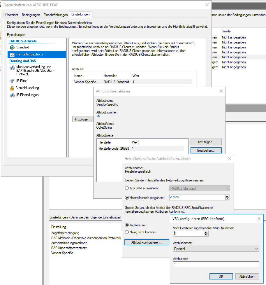

Solution:
If you want to use radius users to access Hivemanager you have to specify the custom attributes.
"Attributwert" (Value): 0=RO 1=SA 2=RWA
Kind regards
