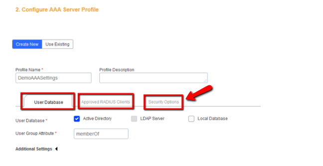

When you reach the part where you are configuring the AAA Server Profile, you'll want to open the Security Options tab:
Here you can upload the certificate that the clients need to match, and set the Radius server to check for the certificate during authentication (TLS authentication).
