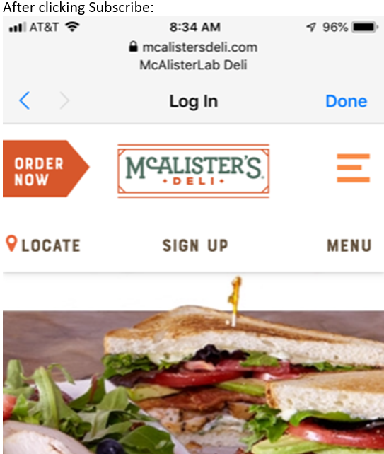

Hi @Nikola Grabovica , thank you for your patience. Since the default CWP is working, we know the firewall ports are correct and the APs are passing the client traffic directly. That would indicate an issue with the HTML code in use. If you'd like to send the code in use to me, I can test in our lab to see if we have the same issue, but we wouldn't be able to support the HTML code directly. My direct email is communityhelp@aerohive.com.
