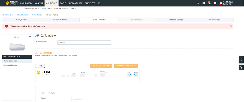

How to enable SNMP in Cloud Manager on live site in device template on eth ports, when I am trying to enable SNMP in wired section I am getting message "You cannot modify the predefined data" how to solve this problem ?

So ok, please help mi with this, how to do it on LIVE site, there is tens of AP650X they have a 2 eth ports bounded to one red0 interface, i need to enable SNMP on all of them, so i believe that i need to do that on red0. I have a network policy and in device template i have AP650X
AP650X-Nufringen (default). Is there a way how to edit exisitng one ? or i need to add second device template ? Or i need to select eth 0 and eth 1 and choose in existing template in asign create new ? what will happen in wired interfaces, it will add a new port type with SNMP enabled and i am done ? I don't want to get site down, so i am just asking. Please help. Thanks

Hi Jozef,
You can't modify default objects in HiveManager.
Therefore instead of trying to edit the existing port type, create a new port and enable SNMP on this. This should then be successful.
