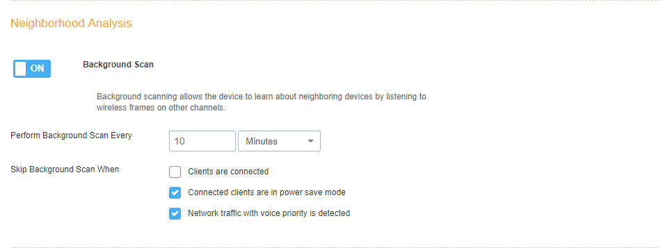

So I am thinking it should Scan now when clients are connected, but is not scanning if it see's Power save mode clients or Voice traffic

There is a small chance that a background scan would cause a client disconnection, but this won't be a problem for the majority of clients on the market today. I would recommend unchecking the box next to "Connected clients are in power save mode" to start with, pushing that change out as a delta configuration update, waiting an hour, then sending me new tech data so I can see if we've improved.

Hi Sam, so I guess here do we want Scans to happen when people are connected would this cause loss of service, what would help us ensure accurate data on the AP given the below is currently used , kind regards

Thank you for that data. We are missing a majority of the background scans requested by the AP, which would explain the blank neighbor list. It also means most of the other data I would check is most likely out of date. I would recommend enabling background scans in as many situations as possible to get this data to populate.
