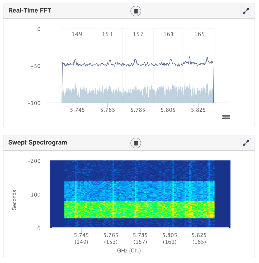

Hard to say what it is, but that lines up with what we're seeing in the "show acsp neighbor" display, that we have very loud neighboring clients. Unfortunately since we don't control all of those neighboring devices, the most we can do is adjust the power on the Aerohive devices to try to find the best balance.

Well, it's definitely an interference problem. I've never seen anything that looks like this before. Looks quite a lot like a jammer of some description?
