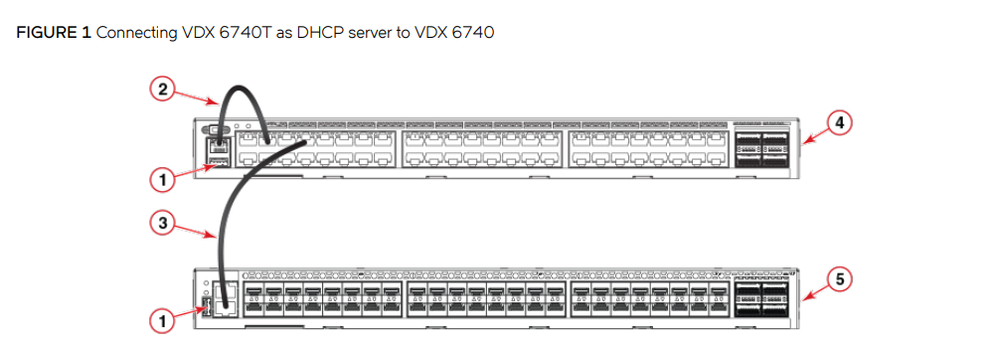

Currently, I have connected exactly as the diagram, as shown below, to gain access to the management console. (I just assumed eth0 = interface management 1/0 = front port on the diagram (RJ-45 under the micro-usb serial port)).
What I am trying to accomplished is to remove the wire #2 in the diagram, and be able to access the management console from anywhere (in-band). I figured SVI/Ve was the more practical way, I am open to another way, as long I can free up the ports.
Originally have set the interface management port to 172.30.0.6/16 which is our main vlan (1000). I am still able to access it that way. Since I am using the 6740 as a leaf all the ports are assigned to VLAN 1000 Access mode. There are a few on other VLAN, but mainly VLAN 1000. The cable going from the interface management 1/0 is going into te1/0/8 and that's assigned to VLAN1000.
As of right now, I can access it either through 172.30.0.6 or 10.0.254.6. But as soon as I unplug the cable from interface management 1/0, I am not able to get to the management console. When I said I removed the cable from eth0 (my previous post), I meant from Interface Management 1/0.
I also have fe1/0/49 & fe1/0/50 in a portchannel uplink to a core switch that holds all the SVI database, if this is a viable option to use. I have te1/0/48 that is a downlink trunk port to another switch both portchannel and te1/0/48 is set to accept all vlans, so both of them are members of vlan 100.
