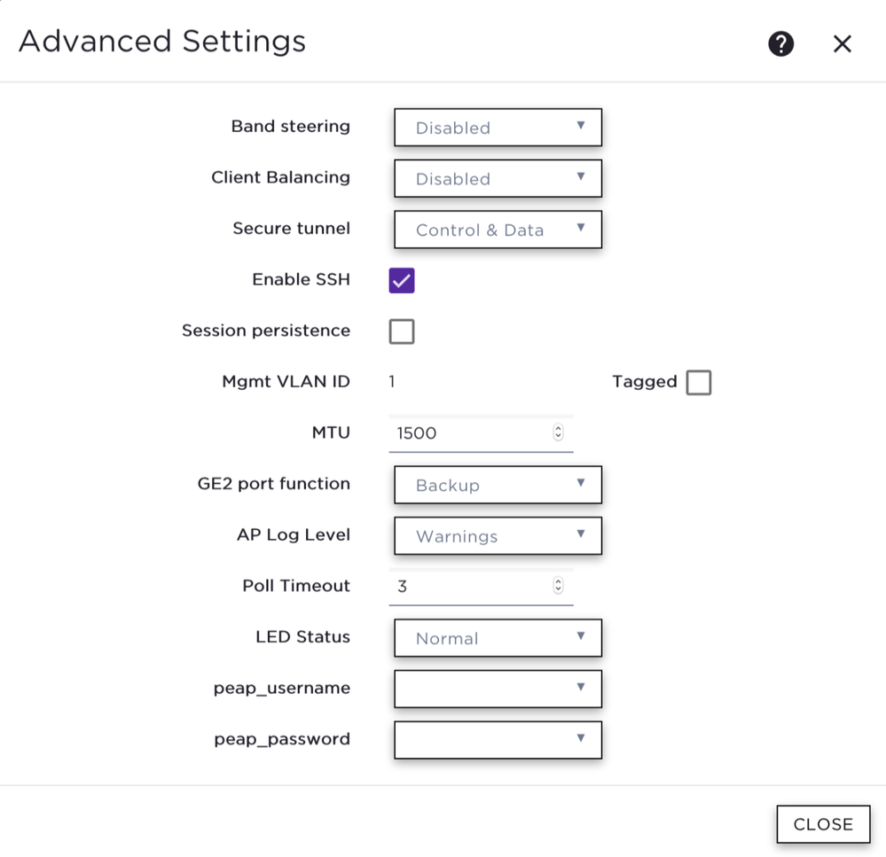

10-22-2020 07:16 AM
Hi Peter,
The option is now available on XCC 5.16.01 as option Site/DeviceGroup/Profile/ADVANCED:
Regards
Mig
