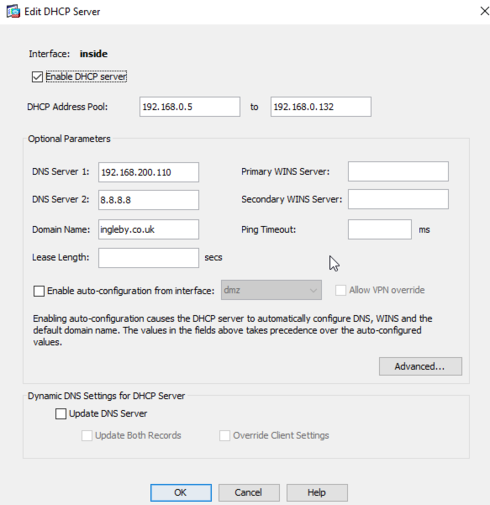

In the DHCP scope the domain has been entered correctly.
I think this might be at fault, but I'm not sure what I can do to correct it?

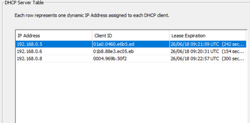

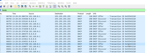

Upgraded all the appliances to version 8.1.3.65 and EXOS 22.5, now I have a new problem in that the DHCP process on the switch keeps repeating through a Discover, Offer then starts all over again?
So it actually gets an IP (192.168.0.8), but just stops there and starts all over again:

Going to try a different DHCP server, after that I'm not sure what else I can do?
Any thoughts? Many thanks.

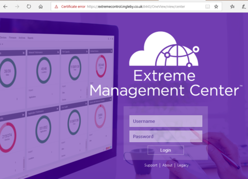

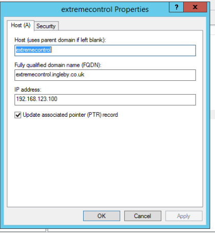

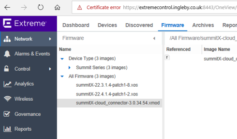

The URL is only displayed as shown in the logs above, I don't see any IP address, just the name extremecontrol, and not the FQDN of extremecontrol.ingleby.co.uk that works OK. The logs do show other information but its pretty much all the same with the switch trying to communicate with the EMC using just https://extremecontrol:8443 instead of https://extremecontrol.ingleby.co.uk:8443
See nslookup below and screenshot from correct URL:
nslookup extremecontrol.ingleby.co.uk
Server: UnKnown
Address: 192.168.200.110
DNS request timed out.
timeout was 2 seconds.
Address: 192.168.123.100
Pretty sure the URL used to say extremecontrol.extremenetworks.com until I added the domain name of Ingleby.co.uk into the DHCP options, now the domain element of the FQDN seems to be missing?
I have the latest Cloud Connector uploaded to Extreme Control:
The version of EMC is 8.1.2.59 - its for a POC, hence why running such a new version.

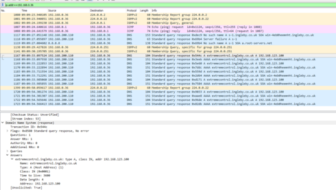

Ok, will do. Also done a quick packet capture and filtered on the IP the switch received and its seems the DNS server 192.168.200.110 is returning the correct resolution to the switch:
