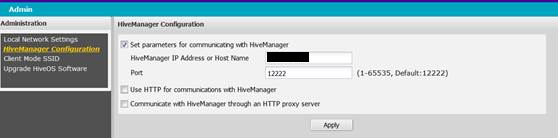

We have 14 pcs. APs connected to the OnPremise controller. There are 11 LifeTime licenses on the controller + we bought 3 APs with licenses for one year. These 3 licenses have expired (can no longer be renewed) due to which the controller does not allow us to change the settings.
Our ideas to solve the problem is to rewire these 3 APs to the cloud controller.
We are keen on keeping the existing configuration. These 3 APs (without licenses) are in branches. Each AP is plugged into a switch in a TRUNK type port. The APs have their addressing set statically - 3 different subnets (unlike the APs located in HQ). APs have so far been configured by entering the controller address and port:
And they appeared in the controller, where the location and setting policy was assigned.
Now we want to make it so that the setting from the OnPremise controller is transferred to the cloud controller. To do this, we need to unplug the 3 APs.
Here is the problem, because we can't restart them - remote locations. We have access after ssh/www. In addition, they must have an output to the INTERNET - CLOUD via proxy (there is such a setting in the AP configuration).
To sum up, the configuration of OnPremise with Cloud Controller must coincide. These 3 APs are in 3 different subnets and have static ipv4 addressing. They have to talk to the Cloud controller via proxy. Is it possible to configure this way?

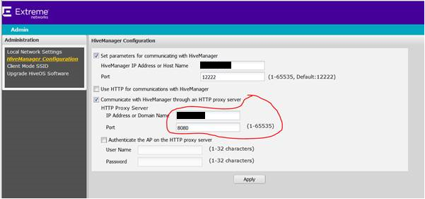

I'm just asking what ip addresses Accesspoint needs to have output to in order to download the configuration from Cloud Manager. I think this should solve my problem.

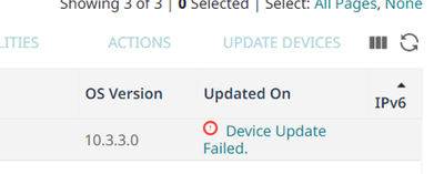

Update: Ap has connected to the Cloud. But trying to send the configuration returns an error. On the firewall allowed only traffic to these subnets and hosts:
54.172.0.252
18.194.95.0/25
18.194.95.0/25
34.253.190.192/26
3.234.248.0/27
44.234.22.80/28
3.67.81.96/27
54.86.95.132
1.1.1.1
8.8.8.8
8.8.4.4
How can I force this to work? Below are the logs
log:AH-8f1740#show log buffered
