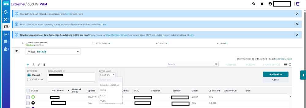

Hi, I am trying to onboard ExtremeCloud IQ controller VE6125 XLarge 10.01.01.0032 by using quick add devices method. The problem I am having is when I entered the Locking ID of the controller manually, it does not give me the option to add the device as Controller as there is no controller options to choose. Please see attached image. Am I doing something wrong here? Any advice to fix this problem is much appreciated.

Ah, gotcha. I just tried it and can confirm that I have the same issue - seems to be an issue on XIQ; its not working as described here: https://documentation.extremenetworks.com/XIQC/10.09.01/DG/GUID-DF5246DD-656C-49F8-A720-2CF6C10E73EB...

yes, followed the second options which is: Add a Controller - quick add. Step 3 does not give option to choose as Controller.

I'm not really understanding your problem and I don't see an attached image, which probably would clear things up. Where do you want to Onboard XIQ-Controller?
