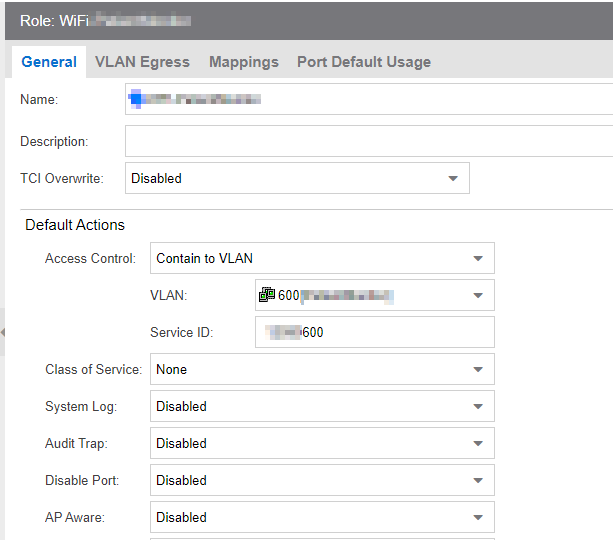

Devices are not getting an IP address when mapped to a certain VLAN after successful authentication.
VLAN mapping on the XCC is configured as below
Switchport where the AP is connected has the VLAN tagged.

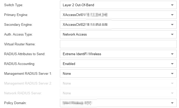

Essentially policy takes care of the vlan / isid without any special tweaking. I am having issues getting captive portal to work (in our case it is hosted on control) but the basic vlan assignment & fa works fine.
Switch Definition for XCC in Control:
XMC/ Control: v8.5.6.17
XCC: 05.36.03.0017
