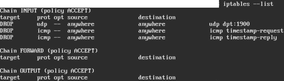

sudo ufw staus
stats: inactive
iptables --list
I dont know, its completely bizarre.
Stefan_K_
Valued Contributor
Try
sudo ufw status
to check the current rules or
sudo ufw disable
to simply disable it. Might also be something in iptables?
