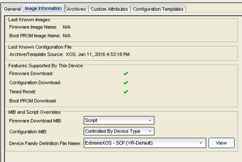

‎01-11-2016 07:38 PM
From the KB you've posted...
"NetSight 6.2 will have additional features in the scripts section so that this change will not be needed."
As you've already installed 6.3 you shouldn't need to change anything in the script to get the backup working so I'd think there is something wrong in the settings.
I've a X430 and the backup with Netsight is working fine with this settings.....
Make sure to use the correct interface (3rd pull-down) - in my case I use the VR-default as that is the interface which is in the same VLAN/subnet as my Netsight.
And also set the SCP settings....
https://extremeportal.force.com/ExtrArticleDetail?an=000082581
