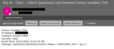

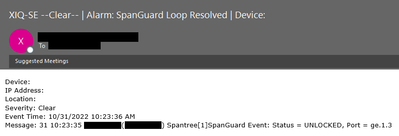

Three of the messages are the same and the fourth is in a slightly different format but with the same details.
This is the identical message I will get 3 copies of:
This is the second message I get a single copy of:
Blacked out portions are the IP address of the switch.
