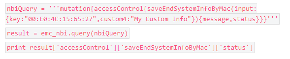

here is an example of GraphQL (NBI) call including the python code to update custom4 information for end-system what does exist in the end-system table:

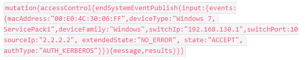

Here is an example of the GraphQL call to create non-existing end-system:

I am sorry the code was crashed by the web page. I had to make it as picture.
I will send you the code directly.
Regards Zdeněk Pala
