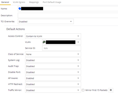

OK I made a dumb mistake. On the XIQ-C in the Auth Role I had the Default Action to deny. Now after setting it to allow it works.
There was also no need to create a rule for the PSK network on XIQ-SE. I've only configured the role with the Access Controle mode set to Contain to VLAN with the VLAN being the untagged VLAN of my AP and on the VLAN Egress tab the VLAN's that should be tagged and untagged.
So basically just this:
Then I create the rule to authenticate the AP via MAC and it works. The switches are EXOS and after authenticating via MAC I can see that the switch automatically tags the Client VLAN and untags the AP VLAN.

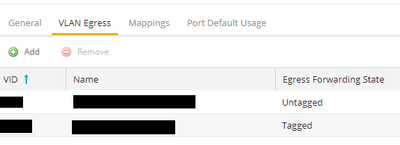

1. Created a role with the AP aware function active and VLAN egress with the VLANs, that should be allowed implicitely:
2. VLAN
The VLANs have only the Names and VID's configured. None of the other options.

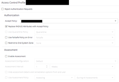

4. My Access Control Profile looks like this:

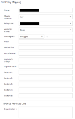

5. My Policy Mapping looks like this:

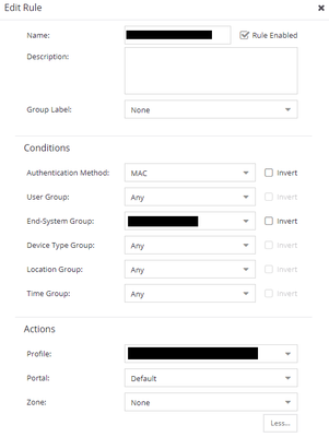

6. And finally my rule looks like this:
