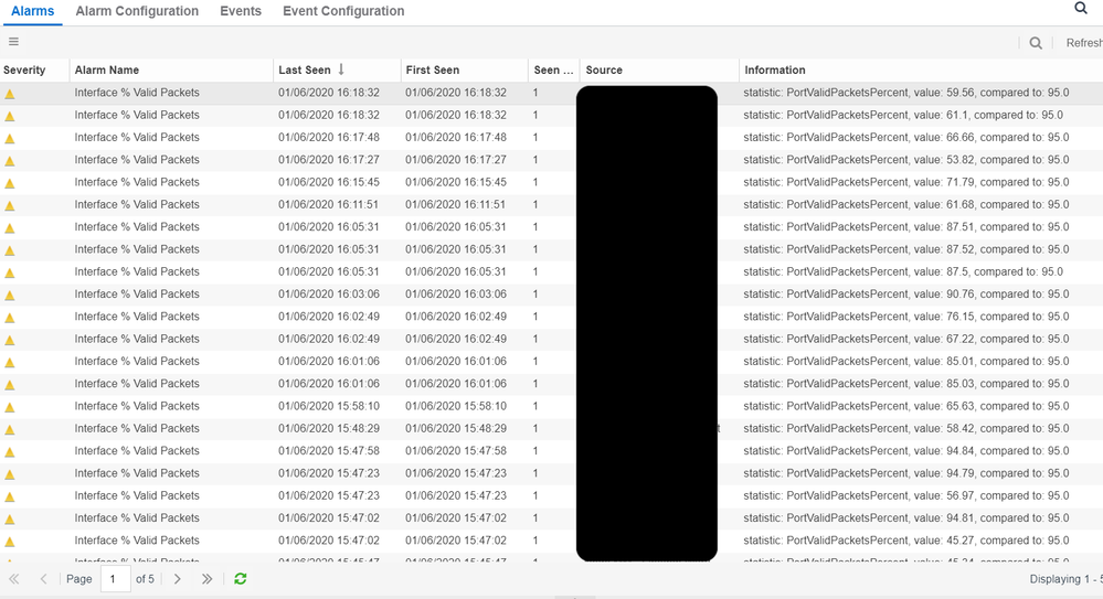

EMC 8.3.2.11 - Alam “statistic: PortValidPacketsPercent, value: xx.xx, compared to: yy.yy”
joshhunter
Hello, can anyone help me with this issue, what does it mean, how can I reduce this noise?
EMC on 8.3.2.11, we have mainly Avaya ERS BOSS switches.
1 REPLY 1
Tomasz
Valued Contributor II
Hello Josh,
You can go to the ‘Alarm Configuration’ tab and modify/disable “Interface % Valid Packets’ alarm. Seems it has a threshold that is violated by the amount of valid packets below 95% expected.
It may be a network health issue or just adjust the alarm’s threshold.
Hope that helps,
Tomasz
