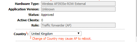

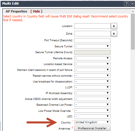

11-20-2018 01:33 PM
It is set per AP, but you can do the change with bulk settings
Per AP in the first config tab:
Bulk (Multi-edit)
As the GUI above says, set this first.
HTH
-Gareth
