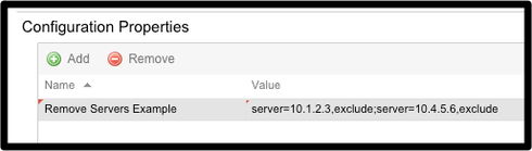

So, I will start off with this - the exclusion commands below will not assist in the FPM count. They are all still there coming into the appliance. We are just choosing to not report on them.
So from Oneview -> Applications -> Purview Appliance -> Configuration ->Configuration Properties
From there, add in your exclusions, and then enforce them.
