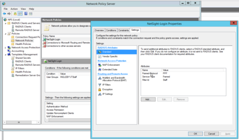

This is the configuration of NPS / RADIUS (Windows 2012), the user group added for ITStaff (which my AD user Mflammia belongs to) and a Filter-Id=staff:

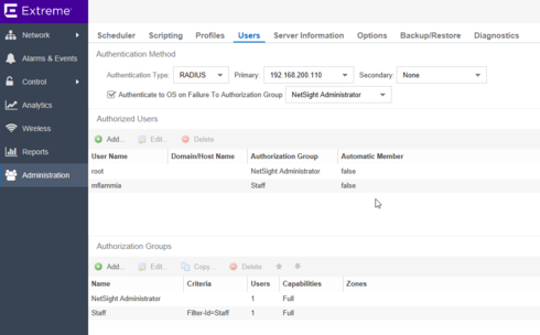

1) If I remove 'mflammia' from the 'Authorised Users' section I can not login - what I was hoping for since NPS is configured to only give a RADIUS accept back if a member belongs to the group ITStaff, and Filter-Id=Staff that the 'Automatic Member' field would kick in showing true for user mflammia and allow me in?

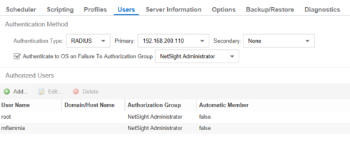

2) I have to specify 'mflammia' in the 'Authorised Users' section in the 'User Name' field and 'Staff' under the 'Authorisation Group' field, as they are mandatory. If I set the 'Authorisation Group' field to 'NetSight Administrator' instead, then the user will get that group when I login. So my question is, what's the point of setting a 'Criteria' in the 'Authorisation Group' section with a 'Filter-ID=Staff', if you have to manually set the authorisation group in the Authorised Users field anyway - its possibly that no user will ever get the staff authorisation group unless a Filter-ID of Staff is passed? Was hoping that passing the Filter-ID=Staff would mean that the authorisation group of Staff is then selected for that particular user?

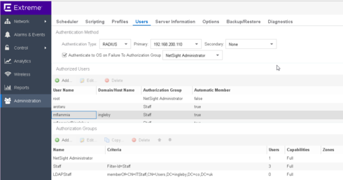

In addition I just wanted to share that you can configure this similarly using LDAP instead of RADIUS. You would need to configure your LDAP connection as usual but you would just need to replace the criteria in the Authorisation Group to use the memberOf (with a '=' instead of a 😅 attribute, as per the example below:
2fe490527cd14ccab34d7deb33fb1975_RackMultipart20170731-24543-11k1ftc-MemberOf_inline.png
