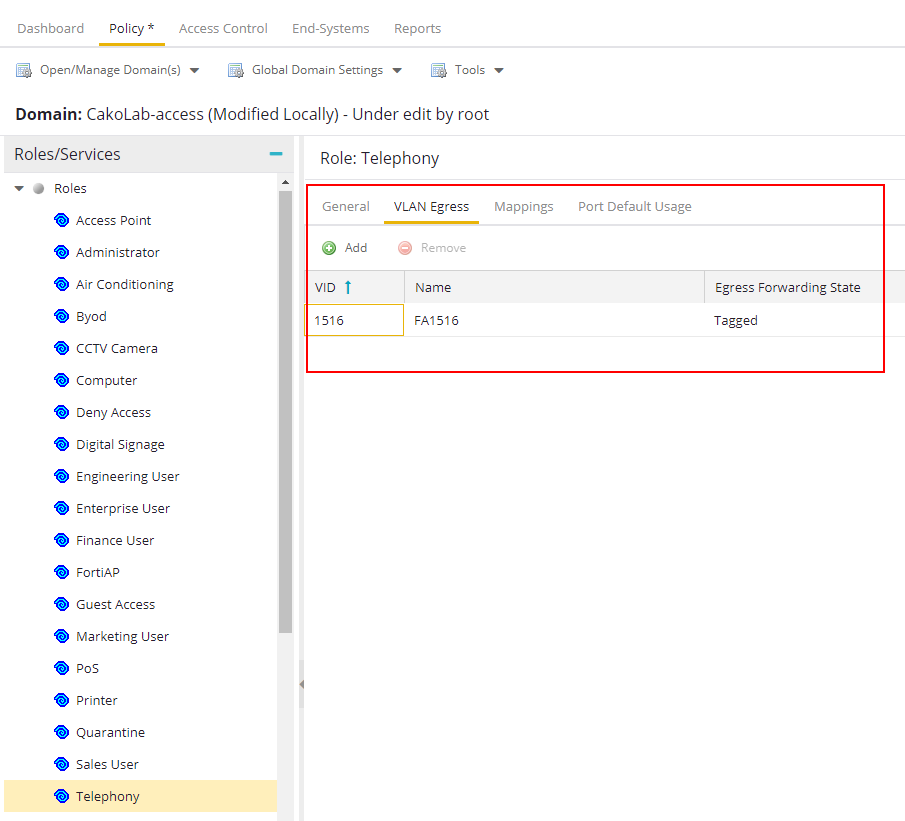

‎12-15-2021 03:48 AM
I would use the option 1: assign tagged VLAN by policy = switch will send frames with VLAN ID and configure LLDP-MED statically to tell the phone to tag its own traffic
‎12-15-2021 03:37 AM
- assign tagged VLAN by policy = switch will send frames with VLAN ID and configure LLDP-MED statically to tell the phone to tag its own traffic
- assign tagged VLAN by policy + use UPM script to configure and reconfigure the LLDP-MED dynamically
- use untagged traffic for both voice and user data, the switch will assign the VLAN based on policy. Not all phones are happy with untagged traffic
here is an example of EXOS config for the option dynamic command execution as a result of radius access accept:
Here is the radius attribute:
Extreme-Security-Profile=UserLogonProfile;LOGOFF-PROFILE=UserLogoffProfile;
