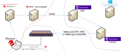

Lab network: actors and data flows
All conversations beetween different vendor are done using standard protocols: Trend Micro TMCM speaks with EMC using syslog and EMC speaks with switches using Radius or SNMP.

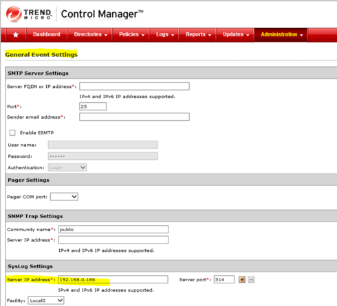

First of all I have configured TMCM to export via syslog the relevant security events to EMC server:

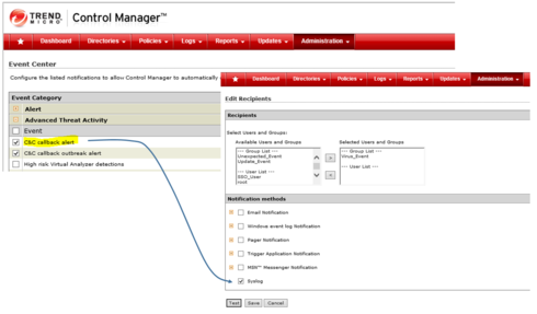

This is a global configuration. After that I have configured TMCM to send only some kind of syslog messages to the EMC (for example C&C botnet callback):
In my lab I have configured TMCM in order to not send messages related to blocked malware.
This is all for TMCM.

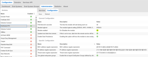

After that I have configured EMC Distributed IPS Connect module. I have enabled the module:

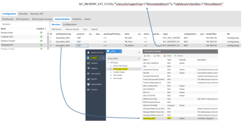

and then I have configured the rules to add infected or hacked host to the Quarantine_MAC group:

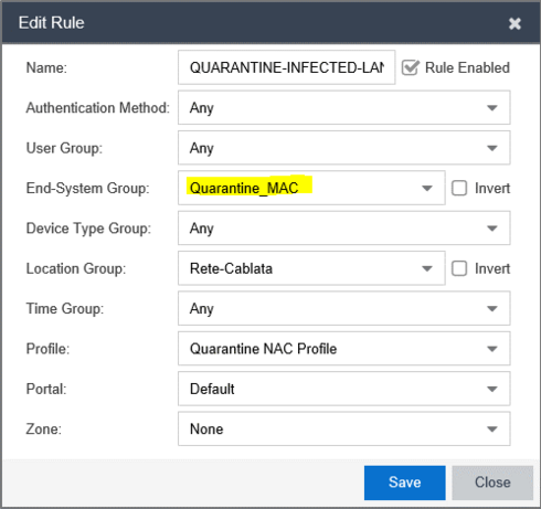

And finally, I have created a NAC rule to move the hosts in Quarantine_MAC Group in a quarantine VLAN. This rule should be placed before other client rules:
