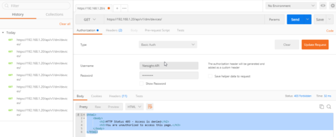

The problem I seem to be experiencing at the moment is what looks to be a rights issue on MobileIron. To validate that I used the 'Postman' addin in Chrome and simulated connecting to the MobileIron API.
To do that if you go to the link below inside Postman:
https://MDMSERVER/api/v1/dm/devices/

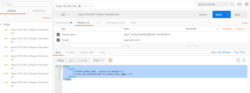

Set the Authorisation to type 'Basic Auth' and enter the username and password configured on MobileIron. Then go to the 'Headers' tab and enter the following:
"Accept" : "application/xml"
Once done, update request and send.
The problem I am then getting is the following:
HTTP Status 403 - Access is denied
You are unauthorized to access this page.
Some screenshots below. Have set the account in MobileIron to be able to use API. The MobileIron version is 9.4.
