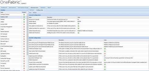

Currently in the process of integrating MobileIron and wondering if anyone has any experience, guidance or any literature on the process.
What I currently have is the 'Install Guide Extreme Connect 2016.pdf' which is very helpful in guiding me how to configure the API integration, the elements in MobileIron I need to configure and some of the customisation I can introduce to on-board devices like the 'Register with MobileIron' button.
Where I'm a little at a loss is configuring the Guest Web Registration piece. I assume I configure this as normal, but its how to tie it into the MobileIron piece I'm stuck.
Think all I perhaps have to do is associate the various MobileIron End-system groups to the various stages of registration?
Its possible I could work it out but wanted to throw this out to the community to see if there was anything out there to assist me further?
Also, any additional documentation I can grab my hands on as its useful to read and at least be aware of what all my options might be.
Many thanks in advance.
