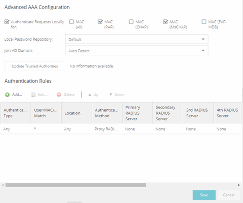

if you are using 802.1x with EAP-TLS, then the NAC can validate the certificates of the clients. Hence the question whether the certificates are created by one or two PKIs. With PEAP, however, client certificates are not necessary.
You do not need a second interface the LDAP and Radius communication is layer 3.
Below a picture of the AAA config. The users mentioned by Stefan are in column 2. In the picture you can see a * which matches every username.
Regards Stephan
Regards Stephan

Are you able to send me a screenshot where exactly to define the username or hostname please?
Cannot find it...
NAC does not need to have another interface in that other vlan, where the other Domain controller is in?  I have to set this up by routing I assume then?

In the AAA config you can define which LDAP-config should be used based on the username or hostname.
e.g.:
Domain1\* ā†’ use LDAP config ā€œDomain1ā€
Domain2\* ā†’ use LDAP config ā€œDomain2ā€
