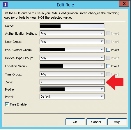

Rainer_Adam
New Contributor III
And then add "simply" the ID of your Zone, in this example "4", this makes the through this rule matrix line authenticated client viewable in Oneview....
be7ddfa8ca28450996bdbc1a0a576bc7_RackMultipart20160304-40771-jxiw4-nac_zone_details_inline.png
Rainer_Adam
New Contributor III
At first you have to enable the row "zone" in the RuleMatrix to make it view and accessable.....
951ede9ac26746cdb0c11b6dacd04b91_RackMultipart20160304-40778-1kq78is-nac_zone_inline.png
