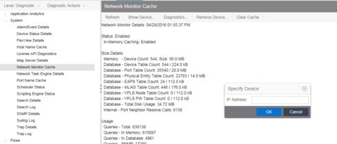

If that doesn't work and running 6.3/7.0 EA you can remove the switches from the cache and then do a rediscover. This will cause the cache to pull all the info from the switches again [which shouldn't have that link again]
32cda9833a0745ba82638c88e9345640_RackMultipart20160429-79406-1ed4y6e-Removedevicecache_inline.png
