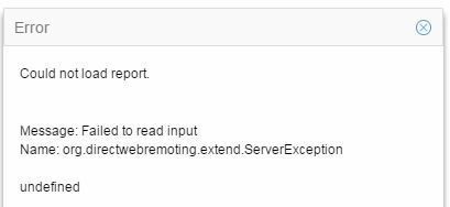

The customer loaded the OVA a couple weeks back and I then added the devices and configured alarms, backups, and such. I thought NetSight was running a little slow but wrote it off as being related to my VPN connection.
Today it seems even slower and I have been getting an error.
How do I check the resources that are available to NetSight?

I assume the VM is Linux ova? Depending on amount of things the server is doing 8 definitely might not be enough.
ssh into the box and run cat /proc/meminfo
Shutdown the Server, take a snapshot and from Vsphere/whatever virtual host, increase the memory, and start the vm back up. Afterwards you should be able the increase in the VM.
You also might need to increase the Heap memory for the Netsight Server.

Went out to do some training yesterday.
Their server guy said the OVA took a terabyte and wanted 12g ram but they only had 4 available.
Then the end of last week they installed more ram and it said it increased NetSight to 6g or 8g I dont remember which but it is running fine.
So the issue was memory and all is good now.
I wish they were all this easy.
