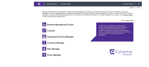

True, when you go to serverip:8080/Clients/index.jsp you should get something like
a4aa60e362d7493ba20056490ebdaa76_RackMultipart20180209-23588-1e25i2u-netsight_inline.png
Then click on Extreme Management center for all the goodies
